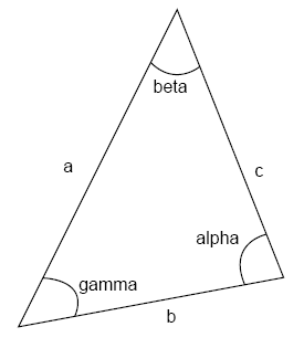

Generic triangles
| Name | Description |
| sasa(a, beta, c) | Returns the value of alpha. |
| sass(a, beta, c) | Returns the value of b. |
| sssa(a, b, c) | Returns the value of alpha. |
