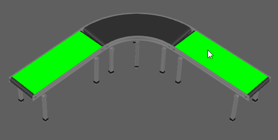

- In the 3D world, right-click and then point to Tools and then click Auto share. This will evaluate all components in the 3D world and try to share as much as possible.
- In the 3D world, select a feature to confirm if it is being shared with features in other components.
