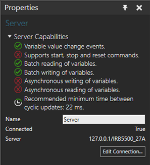

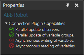

Capabilities
You can verify the capabilities of the ABB Robot plugin and subsequent server connections in the Properties panel.
Plugin
  1. In the Connectivity Configuration panel, select ABB Robot.
  2. In the Properties panel, expand Connection Plugin Capabilities.
Server
  1. In the Connectivity Configuration panel, expand ABB Robot, and then select an active server connection.
  2. In the Properties panel, expand Server Capabilities.

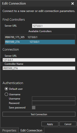

Connection Settings
An ABB Robot plugin connection requires the IP address and name of the robot controller. By default, it is the host machine (localhost). There is also a “Find Controllers” function that can be used to find controllers on the local network (physical controllers only). It also requires the authentication type (DefaultUser or another user defined in the UAS (User Authorization System) of the physical robot controller).
To define a new server connection:
  1. In the Connectivity Configuration panel, click ABB Robot.
  2. On the Connectivity tab, in the Server group, click Add Server.
  3. In the Edit Connection tab, set Server URL and Controller Name. An item from Available Controllers can also be selected. Set Authentication, and then click Test Connection.
  4. If the connection succeeded, click OK, and then click Apply.

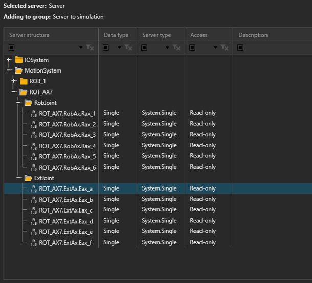

Address Space

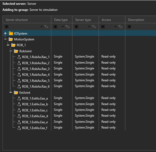

The ABB Robot controller does not have a very well-defined structure to access data. For example, the joints data of a mechanical unit is contained in a JointTarget structure.
The browsing functionality presents the variables in a convenient hierarchical folder structure, and creates child variable nodes for each signal and for each joint value of all mechanical units in a controller.

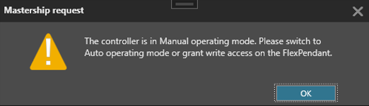

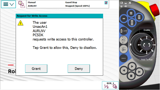

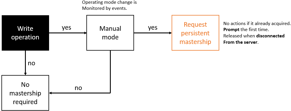

Mastership handling on write operations
In order for the plugin to write values to the ABB robot controller, the controller either needs to be in auto operating mode, or mastership is required.
If the operating mode is Manual, then persistent mastership is required, meaning that the mastership is requested at the first write operation, then released only when the server is disconnected. Signals require mastership in manual mode for writing operations.
The user is prompted with a Mastership request dialog, informing that the controller needs to either be switched to auto operation mode, or grant write access from the FlexPendant.
After the dialog, a similar message as below will appear on the FlexPendant, so to grant write access.
If the operating mode is Auto, mastership is not needed.
The above logic is shown here:

  • When writing values to signals, if the plugin loses mastership (e.g. a user revokes write access from the FlexPendant in manual operating mode), then the user is prompted with the Mastership request dialog, and needs to grant access again using the FlexPendant.

  • Write operations require Mastership. To get Mastership when the robot controller is in Manual mode, the operator has to approve this on the robot controller's FlexPendant. Only one client can have Mastership at any time.

Other Notes
In order to pair mechanical unit joints data, ABB’s JointTarget structure is used. RobJoint contains the six joints values, whereas ExtJoint contains the external joints values.
In the case of seven-axis robots, the seventh axis can be found in a separate mechanical unit (usually named *7), and its value can be found in the first joint value of ExtJoint (ExtAx.Eax_a).

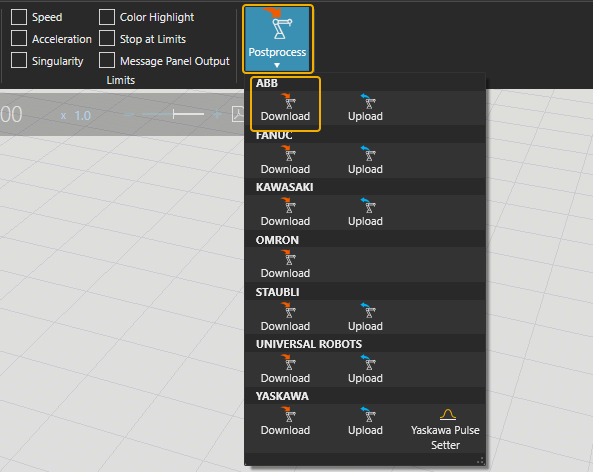

Post Processing the Robot Program
Postprocessor
If you need to translate robot programs from your Visual Components model to the native controller, you can use the Postprocessor.
Note: The Postprocessor is available in the following products:
  1. Visual Components Premium
  2. Visual Components Premium OLP
  3. Visual Components Professional OLP
  4. Visual Components Robotics OLP
For more information on postprocessing using a Visual Components OLP product, see Translate robot program.
To translate the robot program for the real robot controller:
  1. Click the robot (or another device) which program you want to translate.
  2. Click Postprocess from PROGRAM ribbon tools.
  3. Click Download under the correct robot brand name.
  4. Browse the folder where you want to save the program file and give name for the file.
  5. Click Save.
    The file can be transferred to the robot controller
Note: In real robots, run only the robot programs that are translated from calibrated models. Otherwise, there can be unpredictable collisions and errors when executing the program.
