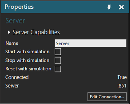

  1. Click the Connectivity tab, and then in the Connectivity Configuration panel, under Beckhoff ADS, click your PLC connection.
  2. To activate the connection, click on the Connect/Disconnect button, and then in the Properties panel, under Server Capabilities, verify Connected is set to True.
Deactivate Connection
To deactivate the connection, click on the Connect/Disconnect button, and then in the Properties panel, under Server Capabilities, verify Connected is set to False.
Troubleshooting
If you are connecting to a TwinCAT project that is not a PLC project, the following error message can appear in the output panel:
Unexpected error occurred in the connection plugin while trying to read from the server. Nullable object must have a value.
The error can be prevented by taking the following steps:
  1. Create a new PLC connection using the Beckhoff ADS plugin.
  2. Connect to the PLC project using ADS port 851.
  3. From the Properties panel uncheck the following properties:
    • Start with simulation
    • Stop with simulation
    • Reset with simulation
  4. Then disconnect from the PLC project.
  5. Edit the connection plugin to use your desired ADS port.
  6. Test if the connection is successful, and activate the connection.
