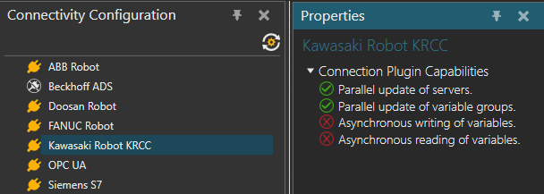

The connector supports the following actions:
  1. Connection to one or more Kawasaki robots at a time.
  2. Reading of joint values.
  3. Reading of inputs and outputs.
  4. Writing outputs.

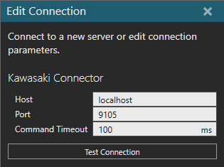

Connecting to Robot
When connecting to a robot, use the correct IP address and port number. By default, the KRCC uses port 9105, 9205, 9305 etc for each connection, but check the correct port number to use when connecting to a real robot.

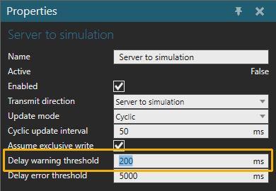

It has been observed with a virtual controller, that the update rate for communication can exceed on average 50ms, especially when the robot is idle. To avoid warning messages and logging of this behavior, consider using a higher Delay warning threshold in the variable group.

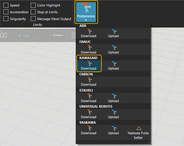

To translate the robot program for the real robot controller:
  1. Click the robot (or another device) which program you want to translate.
  2. Click Postprocess from PROGRAM ribbon tools.
  3. Click Download under the correct robot brand name.
  4. Browse the folder where you want to save the program file and give name for the file.
  5. Click Save.
    The file can be transferred to the robot controller
