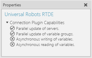

You can verify the capabilities of the Universal Robots RTDE plugin and subsequent server connections in the Properties panel.
Plugin
  1. In the Connectivity Configuration panel, select Universal Robots RTDE.
  2. In the Properties panel, expand Connection Plugin Capabilities.

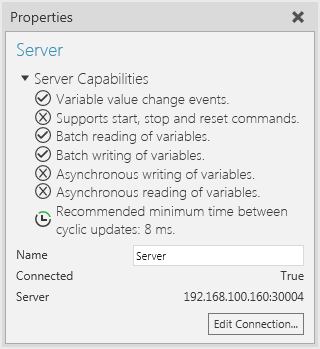

Server
  1. In the Connectivity Configuration panel, expand Universal Robots RTDE, and then select an active server connection.
  2. In the Properties panel, expand Server Capabilities.
Note: The capabilities are the same for each server connection with the Universal Robots RTDE plugin.

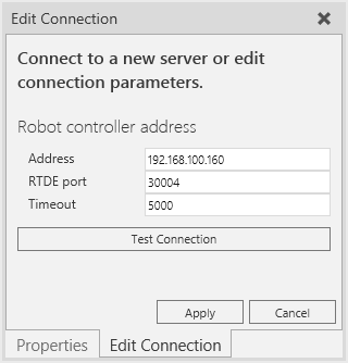

Connection Settings
A Universal Robots RTDE plugin connection requires the IP address and RTDE port of the robot controller and a timeout (in milliseconds). The port should always be 30004 for future proofing. The timeout value is used for initial connect and sync operations, including all configuration changes to recipes.
To define a new server connection:
  1. In the Connectivity Configuration panel, click Universal Robot RTDE.
  2. On the Connectivity tab, in the Server group, click Add Server.
  3. In the Edit Connection tab, set Address, RTDE port and Timeout, and then click Test Connection.
  4. If the connection succeeded, click OK, and then click Apply.

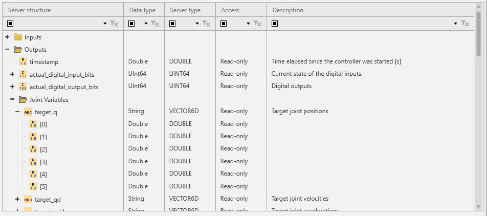

Address Space
The RTDE interface specifies a fixed set of variables that each can be either read or written. The input variables of the controller cannot be read by the client and output variables of the controller cannot be written. However, there are some separate variables that make reading and writing the same thing, for example digital outputs of the controller.
  • Input to controller (write-only in Connectivity feature): standard_digital_output
  • Output from controller (read-only in Connectivity feature): actual_digital_output_bits
The RTDE address space does not have hierarchy, and variables can only be read/write as a whole as part of recipe data packages. However, since the Connectivity core only handles basic data types, the RTDE connection plugin provides access to components of vector variables and single bits of integer variables. The single bit access is needed because the controller's digital inputs and outputs are only available as integers, not single Booleans. The connection plugin also provides read access (writing not supported) to vector output variables from the controller as strings. The vector's elements are converted to decimal strings, using full precision for floating point values and a period "." as decimal delimiter. The element strings are then joined with a single space character as delimiter.
The RTDE connection plugin uses a hardcoded information model of the server address space, which provides browsing capability. This hardcoded model corresponds to the UR controller version 3.3. The RTDE protocol does not include functionality for retrieving information about available variables on the controller. If new controller software versions add variables to the interface, those will not be accessible without updating the connection plugin.
The browsing functionality presents the variables in a more convenient hierarchical folder structure, and creates child variable nodes for vector components and bits in integers. Vectors can also contain integer variables, which can be accessed bit by bit.
Example. Vector variable browsing
Important: The robot RTDE interface variables use radians as the unit for angles in variables, for example current and target joint values. This means they cannot be directly paired to Value properties of DOF objects in the UR robot components. To workaround this issue, UR robot components available in the eCatalog panel have been modeled with a "RTDEJoints" string signal behavior, which can be mapped to the "target_q" output variable in the controller. A script in the robot is used to receive events from that signal, parse its value, and use immediate movements to jump the robot component to the received pose.

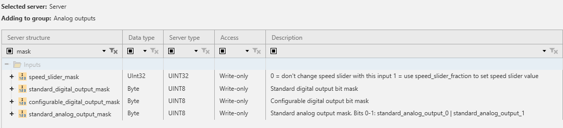

Input mask variables
Four inputs to controller have separate mask variables. These masks act as a filter for applying the values sent by the client. The idea is that the RTDE client does not necessarily want to overwrite all bits in, for example, the variable that controls the "standard digital outputs" of the robot. This allows control over some bits of a variable from the robot program on the controller and some from RTDE clients. These masks create some limitations for using the input variables in Visual Components Premium 4.10.
Important: The RTDE interface does not allow more than one client to access the same controller input variable.
Example. Conditions for modifying standard digital output state on robot controller
  1. Variables standard_digital_output (UINT8) and standard_digital_output_mask (UINT8) must be registered in the same input recipe.
  2. For each bit to apply (set to high or low state) in standard_digital_output, the value of standard_digital_output_mask must have a 1 in the corresponding bit. These must arrive in the same input recipe data package, meaning that setting the mask earlier or later will not result in the digital outputs actually changing on the controller. It seems that the mask is always reset to zero at the controller after processing each input data package.
The effects of those conditions for the Connectivity feature are:
  1. Controller input variables with masks must have the variable and mask variable in the same variable group.
  2. If event-based update mode is used, the mask should be set to a constant value, otherwise value changes could get lost due to the changes being transmitted in different input data packages.

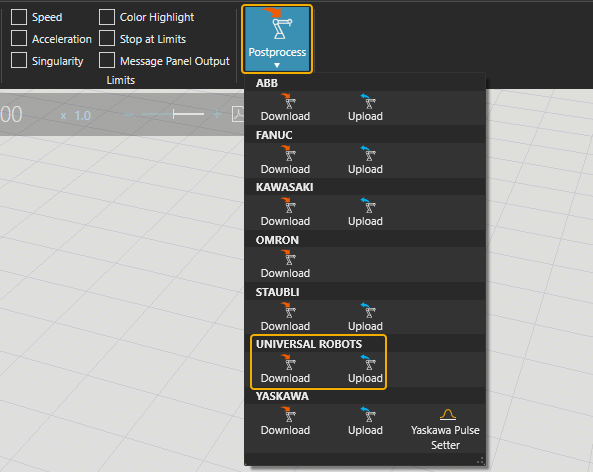

Post Processing the Robot Program
Postprocessor
If you need to translate robot programs from your Visual Components model to the native controller, you can use the Postprocessor.
Note: The Postprocessor is available in the following products:
  1. Visual Components Premium
  2. Visual Components Premium OLP
  3. Visual Components Professional OLP
  4. Visual Components Robotics OLP
For more information on postprocessing using a Visual Components OLP product, see Translate robot program.
To translate the robot program for the real robot controller:
  1. Click the robot (or another device) which program you want to translate.
  2. Click Postprocess from PROGRAM ribbon tools.
  3. Click Download under the correct robot brand name.
  4. Browse the folder where you want to save the program file and give name for the file.
  5. Click Save.
    The file can be transferred to the robot controller
Note: In real robots, run only the robot programs that are translated from calibrated models. Otherwise, there can be unpredictable collisions and errors when executing the program.
For more information check the Visual Components Robotics OLP robot brand specific manuals on the Visual Components OLP Extranet.
