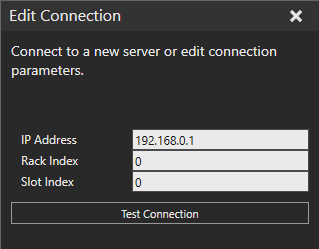

Connection addresses
Define the IP address of the PLC or communication processor module. A normal IPv4 address is used. The connection is always made to the PLC’s TCP port 102.
The rack and slot refer to the PLC CPU module position in a backplane.
PLC type
Rack
Slot
S7-300
0 2
S7-400 N/A N/A
S7-1200
0
0 or 1
S7-1500 0 0 or 1

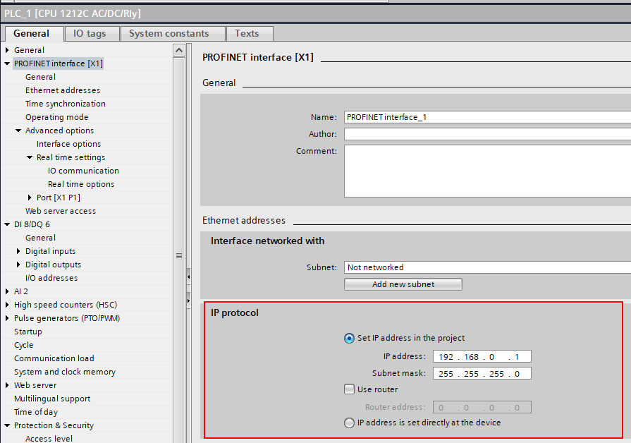

Configure PLC Ethernet interface
Provide the PLC IP address and any other network settings for TCP/IP communication.

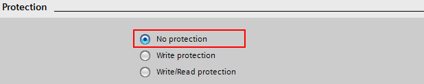

Define Protection & Security setting to allow access

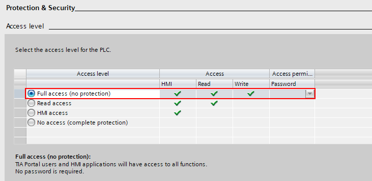

Disable security via access level setting by selecting no protection.
PLCs with older firmware version, it looks like this:

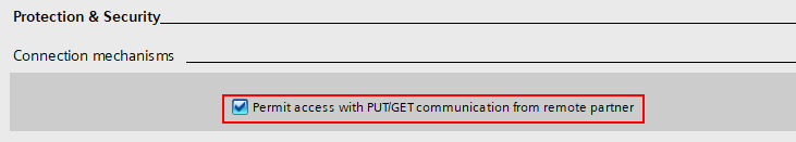

Allow PUT/GET communication.

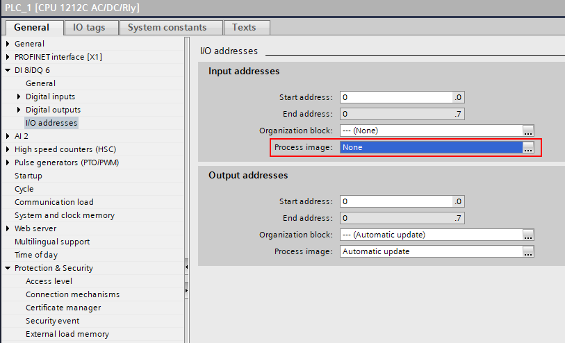

Disable physical input updating (optional)
The input process image can be written to from simulation to emulate PLC inputs. However, updating any physical IOs to the input process image has to be disabled, so the values written from the simulation will not get overwritten on each PLC IO cycle.
