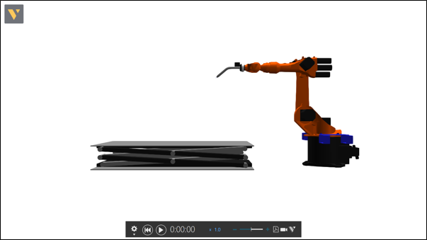

Visualization
The 3D world toolbar allows you to affect the visuals of the viewport.
| 1. | Fill View |
| 2. | Headlight |
| 3. | Camera Projection |
| 4. | Rendering |
| 5. | Frame Visibility |
| 6. | Focus mode |
| 7. | View Editor |

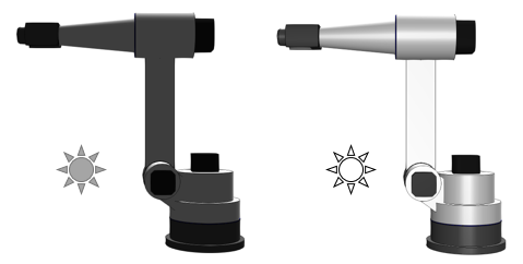

Headlight
You can toggle the use of a directional light from the camera to highlight the surfaces and edges of component geometry. Generally, you would use this when Rendering mode is set to Face edges shaded in order to improve edge detection when teaching a robot.

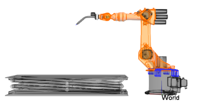

Frame Visibility
You can turn on/off the visibility of all specific types of Frames features in the 3D world.

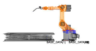

Robot Bases

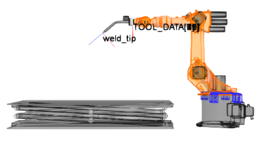

Robot Tools
Robot World Frames
Robot Positions
There are additional display options for robot positions, for example you can show/hide position labels, axes and center points.
