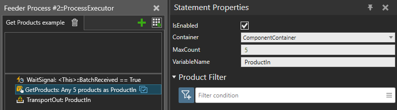

Figure 1. An example Process that waits for external logic to place Product Instances to a component container and trigger a signal. Then it gets references to Product Instances that belong to a specific Process Flow Group to a Process variable “ProductIn”. Finally, it transports the products out to their next Processes

Container |
Component container to read the Product Instances from. |
MaxCount |
An expression for maximum number of Product Instances to return. Must evaluate to an Integer value. Leaving the expression empty and evaluated negative values mean no limit. |
VariableName |
Name of the Process variable to use for storing the result. If the variable exists with correct type already, it is made into a list of Product Instances and the references are appended to it. The variable is created as a list of Product Instances if it does not exist already, even if it will be empty. |
Product Filter |
See Product Filtering |
