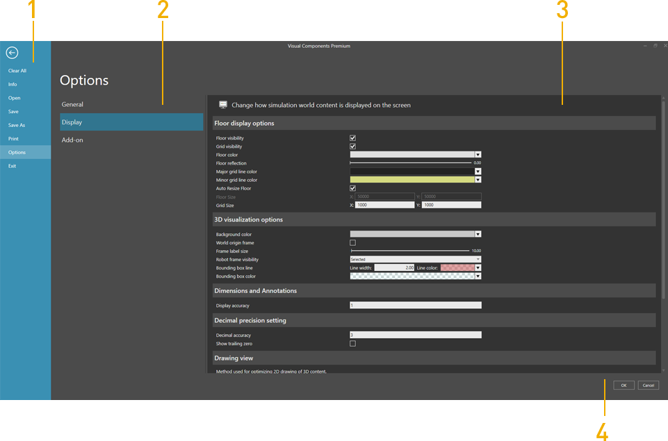

The Backstage view allows you to open and save files as well as edit preferences.
| 1. | Navigation Pane |
| 2. | Sections |
| 3. | Screen |
| 4. | Confirm Options |

Context
The context of the Backstage view depends on the item you select in the Navigation pane.
You can:
- Open and save layouts.
- Print content shown in the 3D world and drawing world.
- Edit and save preferences for selections, navigation, rendering and the language of the user interface.
- Edit the system of measurement for units and quantities.

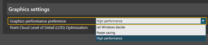

Graphics settings
The Graphics settings allow you to select the graphics performance of your Visual Components product. These settings match the Graphics preference panel in Settings in Microsoft Windows in for example the following location inside the operating system settings:
Settings > System > Display > Graphics (or Graphics settings) > Visual Components Premium 4.10 > Options > Graphics preference.
When you first install your Visual Components product, by default the High performance preference is applied and you will then need to restart the application. And whenever you change your Graphics Performance Preference to any of the following options, to apply the change you should restart the application.
- Let Windows decide
- Power saving
- High performance

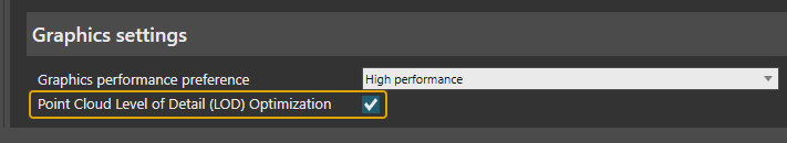

Enable the Point Cloud Level of Detail (LOD) Optimization option to render less points when your point of view in the 3D world is far from the point cloud.
Note: Enabling this option does not require an application restart.
