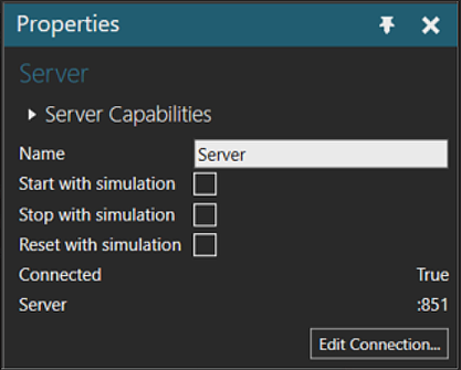

  2. To activate the connection, click on the Connect/Disconnect button, and then in the Properties panel, under Server Capabilities, verify Connected is set to True.
Deactivate Connection
To deactivate the connection, click on the Connect/Disconnect button, and then in the Properties panel, under Server Capabilities, verify Connected is set to False.

  1. Create a new PLC connection using the Beckhoff ADS plugin.
  2. Connect to the PLC project using ADS port 851.
  3. From the Properties panel uncheck the following properties:
    • Start with simulation
    • Stop with simulation
    • Reset with simulation
  4. Then disconnect from the PLC project.
  5. Edit the connection plugin to use your desired ADS port.
  6. Test if the connection is successful, and activate the connection.
