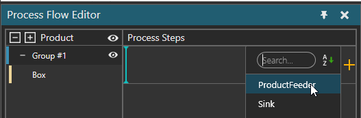

To add a new process step for a flow group, click the plus icon in the end of the row. You can select a process step from a list containing all available processes currently in the layout. You can filter process step from the list by using the Search field. The location of the process step which is being added is indicated with a line. The default location is after the selected process step.

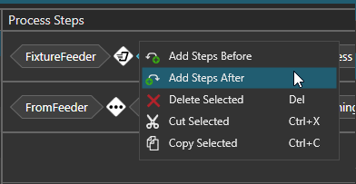

You can also add steps before and after an existing process step in a context menu. Select a process step or a transport controller, open context menu by clicking right mouse button, and then add steps in desired location.

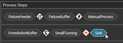

The icon between the process steps indicates which transport controller is used to transporting the product from a process to another. If a transition of any of the all possible routes between process steps requires using multiple transport controllers, the icon shows three dots. If the icon shows red cross, no route exists between the process steps and therefore it is not possible. This happens, when the production flow is not yet defined. However, it can also be by design, if container mode is used in transport in or transport out statements.

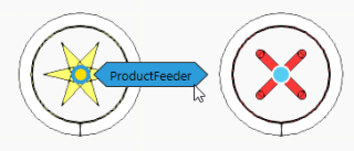

Using Process names To define flow and process steps

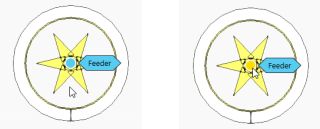

Hover mouse over a transport node. All processes associated with the nodes will be displayed. The node color changes from blue to yellow indicating its processes.
Select (Left-Mouse-Click) on the process label and move your mouse to the next process node you want to connect.
Dotted lines will be shown, meaning you can connect to that process.
Click on the process label you want to connect. The dotted line is turned to a solid line and the flow is defined from one process to another
After this, the process is added automatically to the Process Steps in the Process Flow Editor

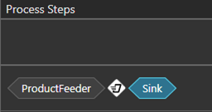

In the Process Steps, search for the process and add it to the sequence.
Search for the process and add it manually.
