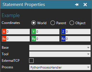

After a process statement has been to added to a routine, you can use the GUI to select the process statement and edit its properties. For example, you can change what process is called by the statement.
