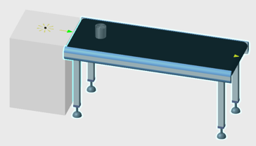

In some cases, an interface is used to connect behaviors in one component to those in other components.
Part transferred from feeder to conveyor using an interface

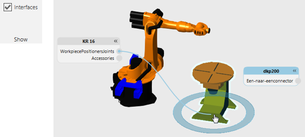

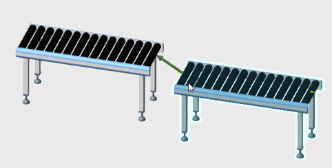

For physical connections, use the PnP command to plug and play components with compatible interfaces, which are located at Frame features and indicated by arrows in the 3D world.
For remote connections, enable the Interfaces toggle and use the connection editors of components to wire abstract interfaces to one another in the 3D world.
