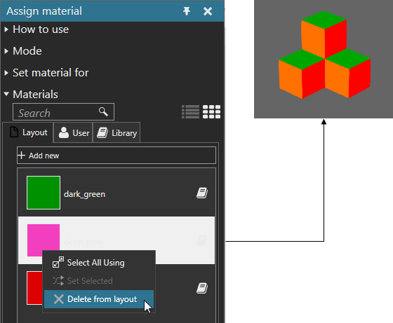

Deleting Materials from Layout
You can delete a material from objects in the 3D world. This is similar to clearing, but you are removing the material of multiple objects.
  2. In the Assign material task pane, expand Materials, and then find a material.
  3. Right-click the material, and then click Delete from layout. This clears the material of all objects using that material. If the material is not stored in a user or system library, the material would be removed and no longer available in the layout.
Example. Delete pink material from objects in 3D world
