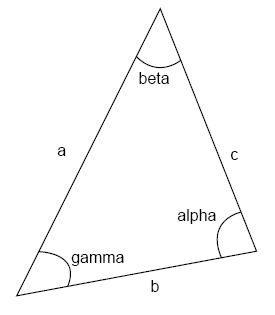

Generic triangles
Name | Description |
sasa(a, beta, c) | Returns the value of alpha. |
sass(a, beta, c) | Returns the value of b. |
sssa(a, b, c) | Returns the value of alpha. |
