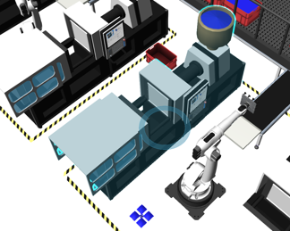

Fill View
You can fill your view with all components or those that are selected in the 3D world. Viewing everything allows you to know the full extent of the current layout and quickly center your view in the 3D world.
Viewing a selection allows you to focus on what is currently being manipulated in the 3D world.

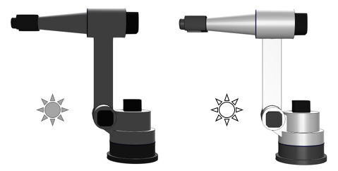

Headlight
You can toggle the use of a directional light from the camera to highlight the surfaces and edges of component geometry. Generally, you would use this when Rendering mode is set to Face edges shaded in order to improve edge detection when teaching a robot.

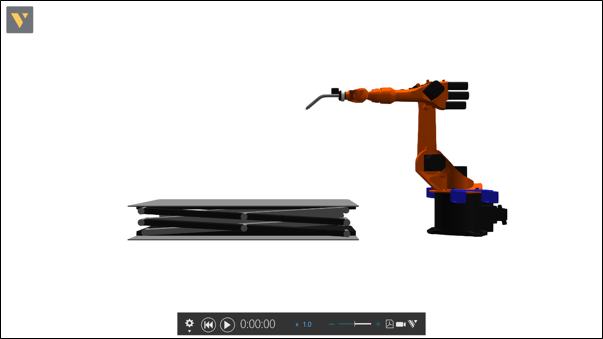

Rendering
You can define the render mode and quality of objects displayed in the 3D world. The following render modes are available:
| Wireframe | All edges shaded |
| Face edges shaded | X-ray shaded |
| Shaded | Material shaded |
| Realistic shaded | Realistic edge shaded |

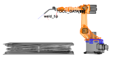

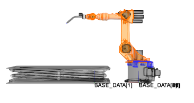

Robot Bases
Robot Tools

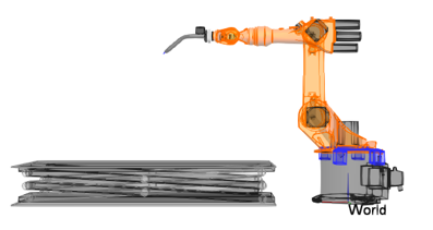

Robot World Frames
Robot Positions
There are additional display options for robot positions, for example you can show/hide position labels, axes and center points.

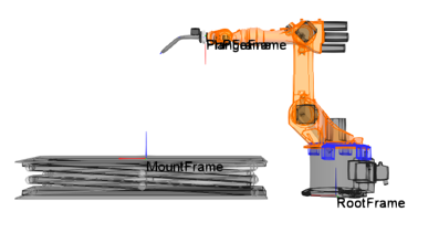

Frame Features

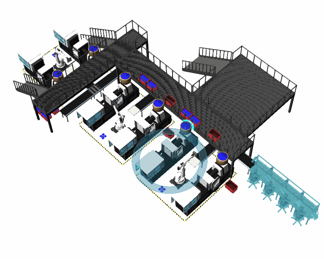

Full-screen Mode
If at any time you want to switch back and forth from the 3D world's full-screen mode, press F11 or the Function key+F11.
