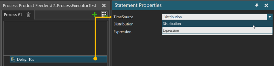

Delay
A Delay statement allows you to delay the process execution by a given amount of time.
Name Description
IsEnabled Turns on/off the execution of this statement.
TimeSource
You can either use Distribution property or Expression property as a time source.
