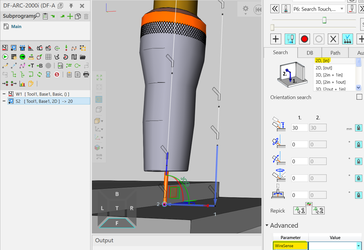

Fronius WireSense is currently supported for Fanuc and Yaskawa robots.
To use the WireSense do below:
  • Add a search advanced property as WireSense
    Note: The parameter is case sensitive. Thus, remember to put it like this WireSense.
  • Use the Search mode as 2D in
