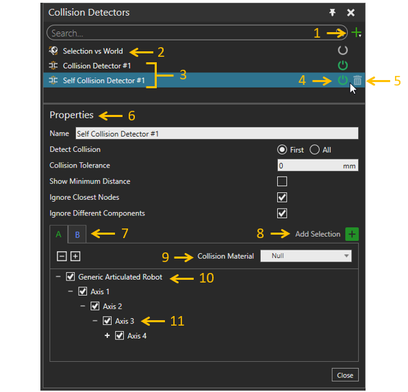

Collision Detectors
- Create a new collision detector.
- Selection vs World collision detector. This compares the selected geometry against the geometries in the 3D world.
- Added collision detectors. These detectors check collisions between A and B geometries.
- Detector on/off button.
- Remove detector.
- Properties:
- Name Name of this collision detector.
- Detect Collision
- First Record the first detected collision.
- All Record all cases of detected collisions.
- Collision Tolerance Collision detection threshold distance.
- Show Minimum Distance Show the minimum distance between collision.
- Ignore Closest Nodes Ignore collisions between immediate nodes that make up a parent-child pair in a component.
- Ignore Different Components Ignore collisions between nodes. Each node in different components that are attached together e.g. Gripper attached to Robot.
- A and B geometries for collision check. A and B can include a set of components from the 3D world.
- Add the selected component to A or B geometries.
- Material of the A or B geometries when the collision happens.
- Single component in the A or B geometries. It can be included or excluded from the check box.
- Node of a component. It can be included or excluded from the check box.
