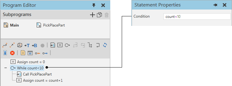

A While statement executes a scope of statements in a loop as long as a condition is true.
Name Description
Condition Defines an expression that when evaluated returns a True or False value.
A True value executes a scope of statements, and then the program would loop back and reevaluate Condition before executing the next iteration.
A False value does not execute a scope of statements and ends the statement.
The expression can reference routine variables, robot I/O ports, and component properties.
To reference a routine variable, the statement and variable must belong to the same routine.
To reference a port in robot, use the format IN[<port number>].
To reference a component property, default properties can be referenced by name, whereas a grouped property must use the format <group/tab Name>::<property name>. In this case, you are referencing the property value.
Note: In order to avoid an endless loop, use a condition that references a routine variable, port in robot, Break statement or a controller property.
