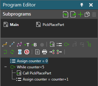

A program variable is a property and global variable of a robot program. You can add program variables using API. For example, you can add a global counter variable to a vcProgram object and use it in the Main routine and subroutines of that program.
| from vcScript import * comp = getComponent() robotExecutor = comp.findBehaviour("Executor") robotProgram = robotExecutor.Program #find or create global counter in robot program counter = robotProgram.getProperty("counter") if not counter: counter = robotProgram.createProperty(VC_INTEGER, "counter") |

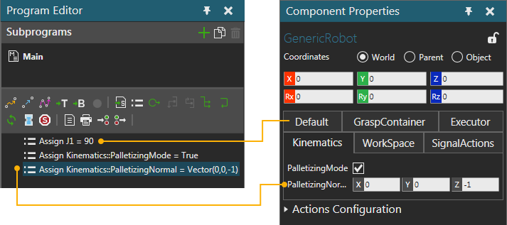

Component Properties
A component property is a global variable of a robot and its program. A default or general property can be referenced by name, whereas a grouped property needs to be referenced using the syntax <group name>::<property name>.
