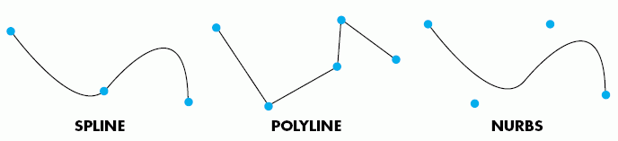

Curve Types
The types of curves supported in the 3D world are:
- Spline
- Polyline
- Non-uniform rational basis spline (NURBS)

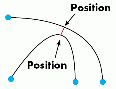

| getCurveMinCurveDistance | 3-tuple (Real min_dist, Real curve_dist, Real othercurve_dist) | Integer curve, Integer othercurve | Returns the minimum distance between two curves at given indices in set.
The returned value describes the minimum distance between curves and minimum distance between either end points of curves.
| getCurveMinDistance | 2-tuple (Real min_dist_to_point, Real curve_dist) | Integer curve, vcVector point | Returns the minimum distance of a curve at a given index in set to a given point as well as the length of curve. |
