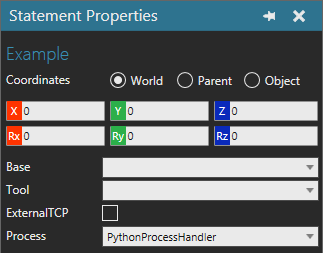

Example. Adding a process statement
| from vcScript import * comp = getComponent() for b in comp.Behaviours: if b.Type == VC_ROBOTEXECUTOR: rx = b break rp = rx.Program main = rp.MainRoutine ps = main.addStatement(VC_STATEMENT_PROCESS) for b in comp.Behaviours: if b.Type == VC_PYTHONPROCESSHANDLER: ph = b break ps.Process = ph ps.Name = "Example" |
After a process statement has been to added to a routine, you can use the GUI to select the process statement and edit its properties. For example, you can change what process is called by the statement.
