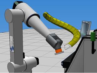

vcSweptVolume
vcSweptVolume is a layout item used to measure and simulate volume displacement of moving objects and detect collisions.
Inherits: vcLayoutItem
A swept volume requires at least two vcNode objects: one designated as the object being swept (InputNodeList) and one designated as the container of swept geometry (TargetNode). In all cases, the target container should remain static and not move during a simulation.
When an object is swept, it is transformed into one or more convex hulls upon movement, an iterative process ensures, and then the swept volume from convex hulls is rendered in 3D world. Swept geometry can be cleared from 3D world or stored in target container, thereby allowing you to save generated swept geometry in a component or layout.

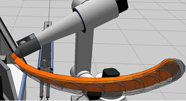

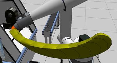

Example. Decomposition and Method results
Decomposition = 0 | Method = 0 (lofting)
Decomposition = 1 | Method = 0 (lofting)
Decomposition = 0 | Method = 1
Decomposition = 1 | Method = 1
