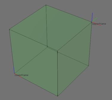

vcVolumeDetector allows you to detect collisions in the 3D world using a box. Collision detection requires at least one node list and a box defined by lower and upper corners.
A collision is detected when nodes in a given list collide with the box. The collision can be tested using geometry or bounding boxes of nodes and limited to the first recorded collision or all collisions.
| Corner1 | vcVector | RW | Defines the lower corner of box in World coordinate system. |
| Corner2 | vcVector | RW | Defines the upper corner of box in World coordinate system. |
