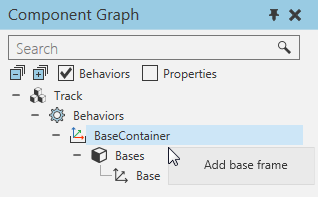

Base Container
A Base Container is a container of Frame features used as base frames.
Frames in a Base Container are listed with the behavior in the Component Graph panel and managed using a Bases element.
