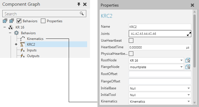

Assignment
In all cases, a kinematics type behavior must be assigned to a Robot Controller behavior in order to be used when solving kinematic equations.

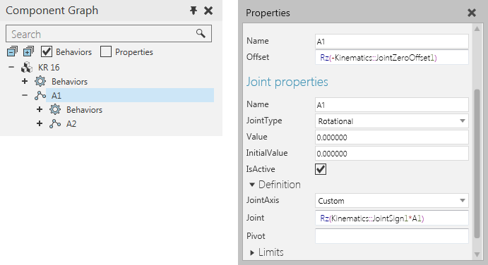

The use of a kinematics type behavior does not remove the need to properly define the joints of a component.
