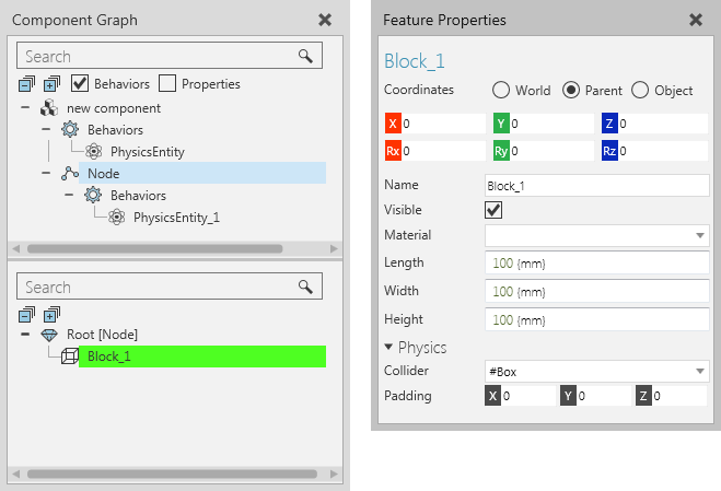

Generally, a component requires at least one Physics Entity behavior to support the use of colliders with features and define a node as a rigid body. When you set the Collider property of a feature, a Physics Entity behavior will be automatically created if one does not exist in the same node as that feature.
