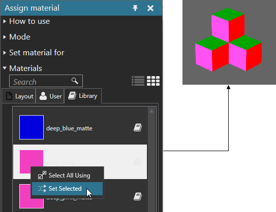

Setting Material
You can set the material of one or more objects in the 3D world. This is similar to assigning, but you are setting the material of multiple objects.
  1. On the MODELING tab, in the Geometry group, click the Tools arrow, and then under Material, click Assign.
  2. In the Assign material task pane, expand Materials, and then find a material.
  3. Right-click the material, and then click Select All Using.
  4. Right-click another material, and then click Set Selected. Objects with the selected material will be assigned the other material.
Example. Change selected material of faces to pink
