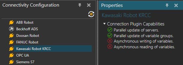

The connector supports the following actions:
  1. Connection to one or more Kawasaki robots at a time.
  2. Reading of joint values.
  3. Reading of inputs and outputs.
  4. Writing outputs.
In terms of technology, the KRCC library made by Kawasaki is used for communication.

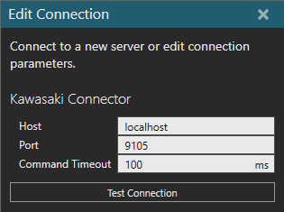

Connecting to Robot
When connecting to a robot, use the correct IP address and port number. By default, the KRCC uses port 9105, 9205, 9305 etc for each connection, but check the correct port number to use when connecting to a real robot.
Mapping variables
The Movement and IO folders for each connected robot, contain the variables for joint values and IO. The available IO is based on the connected robot. The IO ranges adhere to Kawasaki specification, for example 1-32 for outputs and 1001-1032 for inputs.

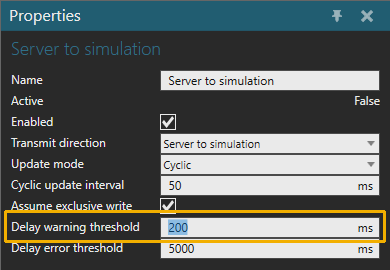

Recommendations
It has been observed with a virtual controller, that the update rate for communication can exceed on average 50ms, especially when the robot is idle. To avoid warning messages and logging of this behavior, consider using a higher Delay warning threshold in the variable group.
