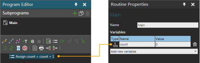

Using Process Variables
Process variables are local variables in a process specific to a routine. A variable in a routine can only be set and referred in the same routine. However, both process requirements and process routine statements of a routine can access the same variables.
See also Process Statement Expressions.
Static Variables
Static process routine variables and they created manually from the user interface and remain between simulation runs.
The value of a variable is reset to the default value of the data type on simulation reset and simulation start, but not for each process routine execution.
