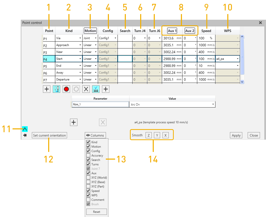

Point control window opens from Test path section in Path setup. In the point control user interface, all the points in the path can be modified. The parameters to modify are: Kind, Motion type, robot Configuration, Search assigned to the point (memory slot value of search), Turn of robot joint J6 (also J4 for some robots), Auxiliary axis values, Speed and WPS.
To modify the parameters, select the points to be modified, modify the values and click Apply.

No. |
Name |
Description |
1. |
Point |
Shows all the points in the weld path |
2. |
Kind |
Denotes if the point is an approach, via start point and so on |
3. |
Motion |
Denotes if the point is linear or point to point |
4. |
Config |
Denotes the configuration of the robot |
5. |
Search |
The memory location for search is inserted over here to link the weld path to search function |
6. |
Turn J4 |
Specify the turn for J4 joint of the robot |
7. |
Turn J6 |
Specify the turn for J6 joint of the robot |
8. |
Aux |
Specifies the auxiliary axes (Robot positioner, Workpiece positioner) joint values. |
9. |
Speed |
Specifies speed values |
10. |
WPS |
Apply welding parameter template to the point |
11. |
WPS view |
Click on this arrow to view the welding parameters for selected template. Described more below |
12. |
Set current orientation |
Change the robot orientation for certain or multiple points and click on set current orientation. |
13. |
Columns |
Select the needed columns to be visible in Point control window |
14. |
Smooth XYZ |
Smoothens the tool path around Z, Y and/or X axis for the selected points in the path. To smoothen the path, multiselect the points and click Z, Y and/or X. |

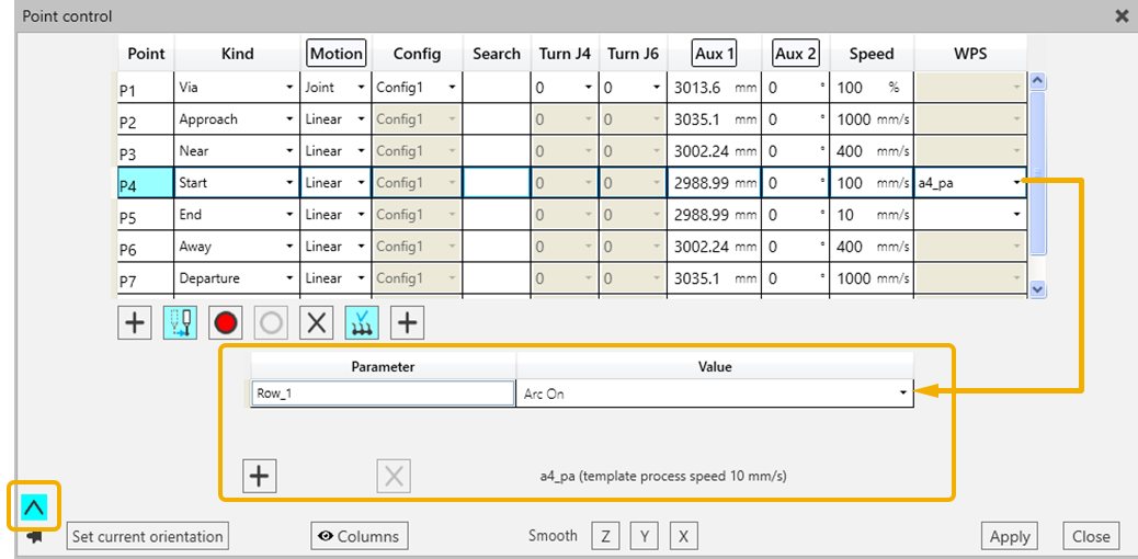

WPS view
The WPS view allows to:
- See the WPS parameters for Process start, Process end or Process points.
- Edit (add/delete/modify) the parameters from this view.
- See the template process speed.
Hit apply to save any changes you make.

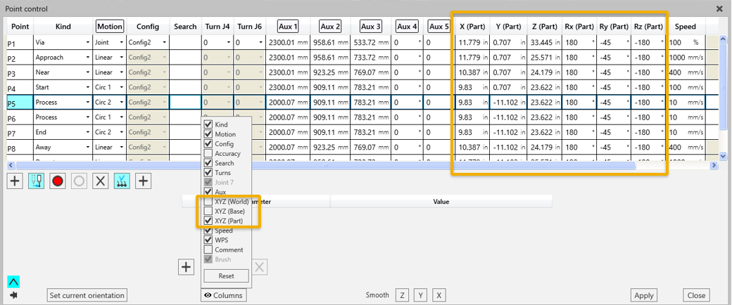

Point Coordinate Visibility
You can enable the XYZ columns to view the Point wr.t World or Base or Part coordinates.

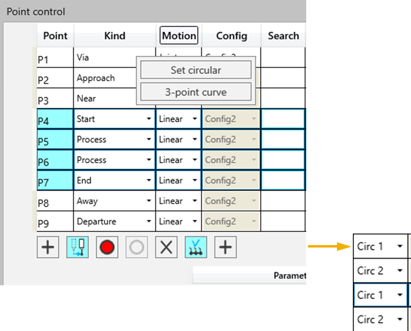

Circularize function
Set circular
If the points in the path are Linear and you need to change it to circular move points, then use the Set circular function. Multiselect the points that are needed to be converted to Circ Points and choose the Set Circular option.
3-point curve
Select 3 points. Click on 3-point curve. Hit apply. A curve will be generated using the first and last point.

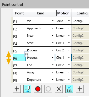

Re-sequence points
You can re-sequence points by dragging and dropping the point as needed.
