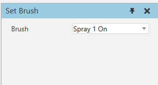

Set Brush

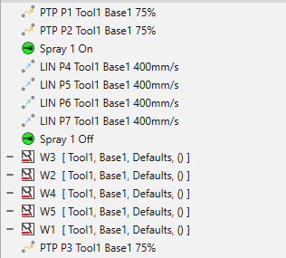

The Set Brush tool allows you to turn on the spray and turn off the spray in between PTP and LIN points.
It can be found from the Statements toolbar.
Insert the Set brush statement wherever needed. A property window Set Brush appears, wherein you can choose from the list if you want to use turn spray or off.
