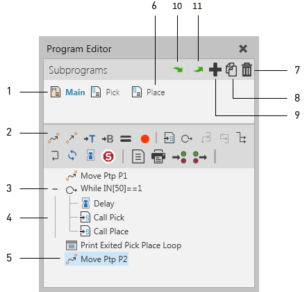

The Program Editor panel allows you to view and edit a robot program, preview motions, and program other types of components using RSL statements.
 1. Main Routine
 2. Statements Toolbar
 3. Conditional Statement
 4. Nested Statement
 5. Motion Type Statement
 6. Subroutine
 7. Delete Selected Routine
 8. Duplicate Selected Routine
 9. Add Subroutine
 10. Import Program
 11. Export Program

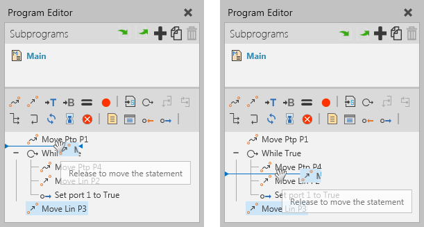

Program
The program of a robot is its job and is saved with the robot in a layout. If you need to rearrange statements in a program, drag and drop a statement before or after another statement. The place where you are inserting a statement is shown by a line that will also indicate at what level you are inserting a statement.

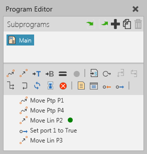

When running a simulation, the current statement being executed in a robot program is indicated by an arrow in the right-side of the Program Editor panel.
