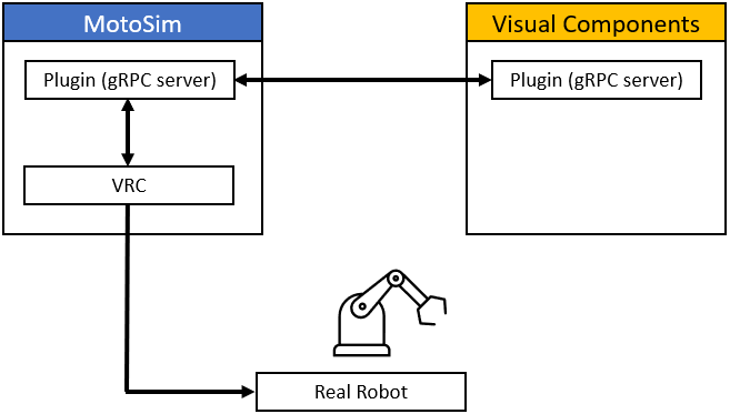

The connector supports a direct connection to a virtual Yaskawa robot controller (VRC) running in MotoSim. A connection to a real robot is created via a network connection in MotoSim. MotoSim and Visual Components will in most cases be running on the same computer. However it is possible to run Visual Components on one computer and connect to the IP address of another computer running MotoSim.

In terms of technology, a MotoSim plugin is used to communicate with Visual Components. The connection uses MotoSim VRC API created by Yaskawa and gRPC. Therefore, MotoSim is required to connect with a robot.

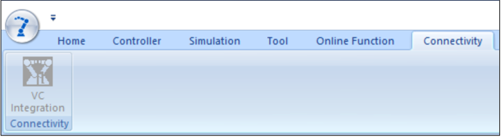

The plugin is added to the Plugins folder of your MotoSim public documents and includes a Yaskawa.json configuration file used for identifying the IO and variables of a Yaskawa controller, for example YRC1000.

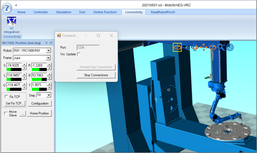

After installing the plugin, run MotoSim and confirm the plugin is available in the Connectivity tab.
Using the MotoSim plugin
Open your MotoSim project. Then use the MotoSim plugin to define a Port number and start the connection. You can now connect Visual Components to the robots in your project.
Note: In most cases, it is recommended to keep the Vrc Update property unchecked, especially when MotoSim is connected to a real robot.

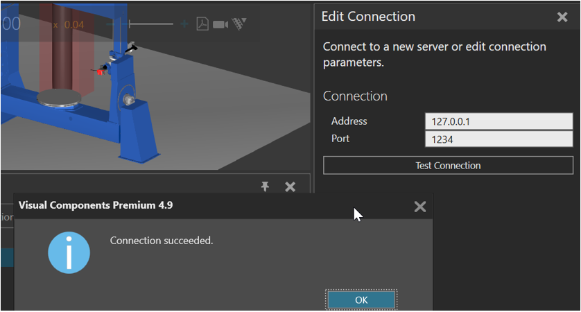

Connecting to Robot
When connecting to a robot, use the correct IP Address and Port number.

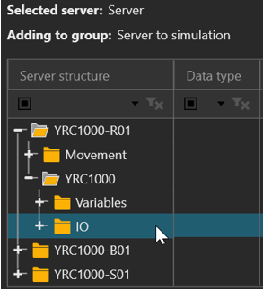

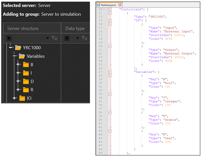

Mapping Variables
The Movement, IO and Variables folders for each connected robot contain the variables for joint values, IO, and variables used in Yaskawa programs.
The available IO and program Variables are based on the connected robot and its controller, which is defined in the Yaskawa.json configuration file. Make changes to the configuration file as needed for your projects.

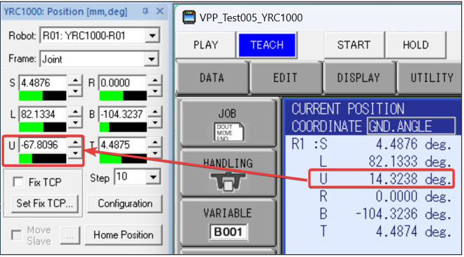

About Movement variables

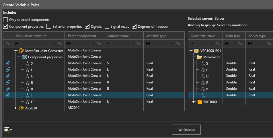

In MotoSim v2022 there is a known issue where the joint values of the controller do not correspond to the joint values in the Position panel. The robots in Visual Components are modeled to respect controller values. As a result, the robot movements in your Visual Components projects might not match those in MotoSim, since the joint values are read from MotoSim.

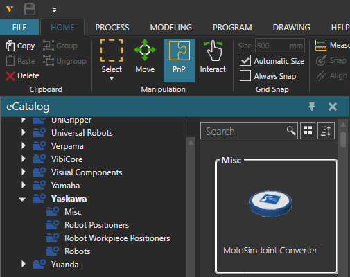

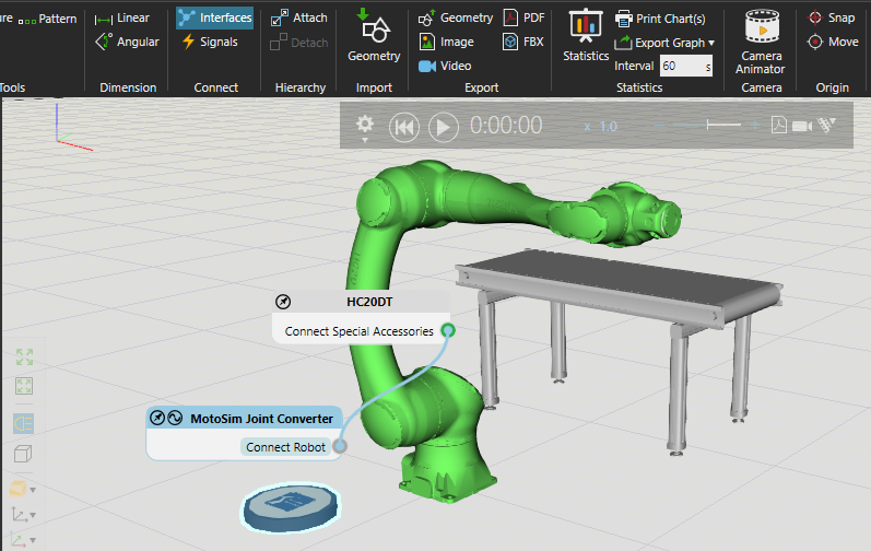

The MotoSim Joint Converter component in the eCatalog is a tool you can use as a workaround for this issue.
First, using the Interfaces tool, remotely connect the robot in Visual Components to the MotoSim Joint Converter component in your layout.
Next, map the movement variables of the connected Yaskawa controller to the SLURBT properties of the MotoSim Joint Converter component.

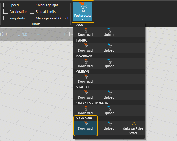

Postprocessing the Robot Program
Postprocessor
If you need to translate robot programs from your Visual Components model to the native controller, you can use the Postprocessor.
Note: The Postprocessor is available in the following products:
  1. Visual Components Premium
  2. Visual Components Premium OLP
  3. Visual Components Professional OLP
  4. Visual Components Robotics OLP
For more information on postprocessing using a Visual Components OLP product, see Translate robot program.
To translate the robot program for the real robot controller:
  1. Click the robot (or another device) which program you want to translate.
  2. Click Postprocess from PROGRAM ribbon tools.
  3. Click Download under the correct robot brand name.
  4. Browse the folder where you want to save the program file and give name for the file.
  5. Click Save.
    The file can be transferred to the robot controller
Note: In real robots, run only the robot programs that are translated from calibrated models. Otherwise, there can be unpredictable collisions and errors when executing the program.
