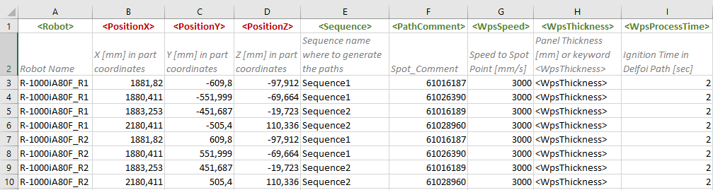

<PositionX> |
mm |
Spot Point X-coordinate value in part coordinates |
<PositionY> |
mm |
Spot Point Y-coordinate value in part coordinates |
<PositionZ> |
mm |
Spot Point Z-coordinate value in part coordinates |
<Robot> |
active robot in layout |
string |
Robot Name in layout if csv file contains spot data for multiple robots |
<Sequence> |
active sequence in layout |
string |
Sequence name where to generate the paths |
<PathComment> |
string |
Comment for path |
<WpsSpeed> |
mm/s |
Motion speed to spot point |
<WpsThickness> |
<WpsThickness> |
mm |
Panel thickness (can be automatically measured from the model) |

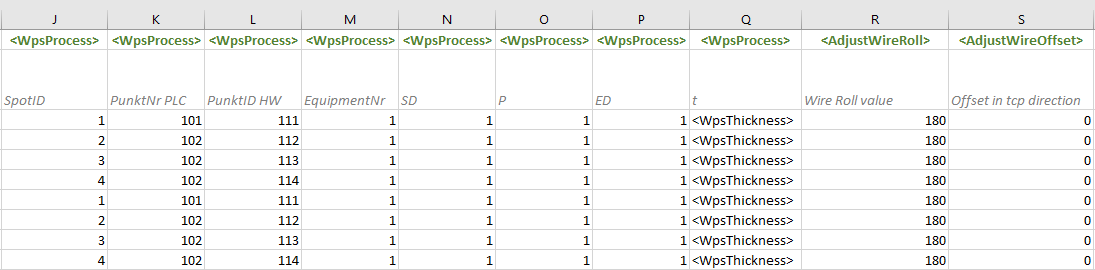

<WpsProcessTime> |
sec |
Spot Weld process time (for simulation purposes) |
<WpsProcess> |
sting |
WPS process parameter, CSV can have multiple columns with this keyword. Second row in CSV will define process parameter name |

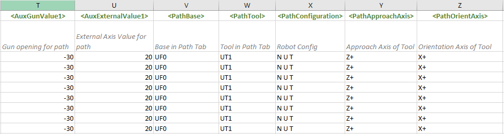

<AdjustWireRoll> |
angle |
Rotation over TCP |
<AdjustWireOffset> |
mm |
Offset in TCP direction |
<AuxGunValue1> |
mm or angle |
Spot Gun opening for path, also <AuxGunValue2> available |
<AuxExternalValue1> |
mm or angle |
External Axis Value for path, AuxExternalValue1…AuxExternalValue12 available |
<PathBase> |
String |
Robot Base definition for Path |
<PathTool> |
String |
Robot Tool definition for Path |
<PathConfiguration> |
String |
Robot Configuration definition for path |
<PathApproachAxis> |
String |
Approach Axis of Tool (TCP) |
<PathOrientAxis> |
String |
Orientation Axis of Tool (TCP) |

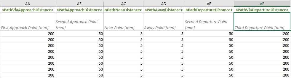

<PathViaApproachDistance> |
mm |
First Approach Point [mm], if cell is empty, the point is not generated |
<PathApproachDistance> |
mm |
Second Approach Point [mm], if cell is empty, the point is not generated |
<PathNearDistance> |
mm |
Near Point [mm], if cell is empty, the point is not generated |
<PathAwayDistance> |
mm |
Away Point [mm], if cell is empty, the point is not generated |
<PathDepartureDistance> |
mm |
Second Departure Point [mm], if cell is empty, the point is not generated |
<PathViaDepartureDistance> |
mm |
Third Departure Point [mm], if cell is empty, the point is not generated |
