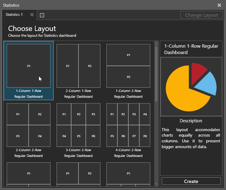

Choose a Layout
The Statistics dashboard divides content into separate tabs. Each tab uses a layout and grid system for organizing charts by columns and rows.
By default, an empty tab will display a view for choosing a layout. A layout defines how many charts and where they are placed in the view of that tab.
  1. Select a layout. This displays a preview of the layout in the side panel.
  2. Do one of the following:
    • Double-click the layout.
    • In the side panel, click Create.
  3. If you need to change the layout, click Change Layout and then repeat steps 1 and 2.
Note: Changing the layout will not remove charts unless you are switching to a layout with less placeholders.

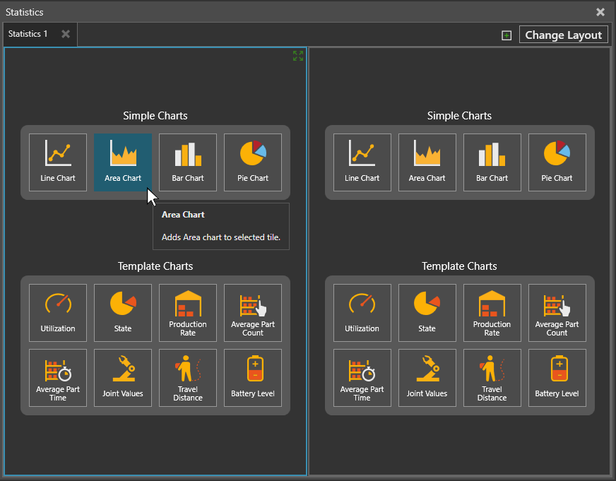

Choose a Chart
By default, a placeholder without a chart will display options for adding a chart. You can either create a new chart from scratch or use a template. If you want to use a template, you must first select a component in the 3D world. Generally, the selected component must have a Statistics behavior or be the type of component required by the template.

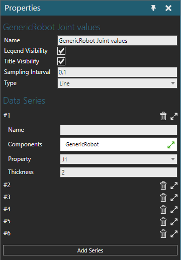

Edit Chart Properties
A chart plots a data series or the values of a property in a component. A data series can contain data from multiple components that have a common property. A chart can plot more than one data series and have its own sampling interval. A sampling interval defines how often the value of a data series is plotted in a chart. By default, all charts use a global sampling interval.
A chart contains the following properties.
  • Name - Defines the name of the chart.
  • Legend Visibility - Displays the legend of the chart and its data series.
  • Title Visibility - Displays the title of the chart.
  • Sampling Interval - Defines the sampling interval of the chart for plotting its data series. A -1 value means the chart uses the global sampling interval.
  • Type - Defines the chart type.
  • Data Series - A set of properties for adding and editing data series in the chart.
    • Add Series - Creates a new data series.
    • Index - Indicates the order of the data series in the chart with additional options for deleting, collapsing and expanding the data series.
    • Name - Defines the name of the data series.
    • Components - Defines a list of one or more components in the 3D world referenced by the data series.
    • Property - Defines which property in the list of components whose value is reported by the data series. Supported property types: Real, integer.
    • Thickness - Defines the display thickness of the data series in the chart.

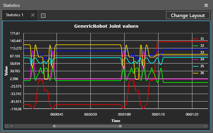

Plot Data
A chart will plot data when you run a simulation based on its sampling interval. If you reset and run a new simulation, data from the previous simulation will be cleared from all charts in the Statistics dashboard.
Note: A chart is a layout item, so charts can be saved with a layout. This does not include plotted data.
View Data
You can read, zoom in or out, pan and focus on data displayed in a chart. These actions, of course, depend on the chart type.
  1. Do one or more of the following:
    • To read the value of a data series in a chart, point at the data series to display a label.
    • To zoom in or out on a chart, point at the chart, and then rotate the mouse wheel forward to zoom in or backward to zoom out.
      Tip: On the scroll bar there is a button to reset the view of the chart. You can also use either end of the scroll box to expand or trim the view.
    • To pan a chart, use the arrows of the scroll bar or drag its scroll box. If no scroll bar is displayed, zoom in on the chart.
    • To focus on a range of data in a chart, point at the beginning or end of the range in the chart, and then drag the pointer to select and view that data.
