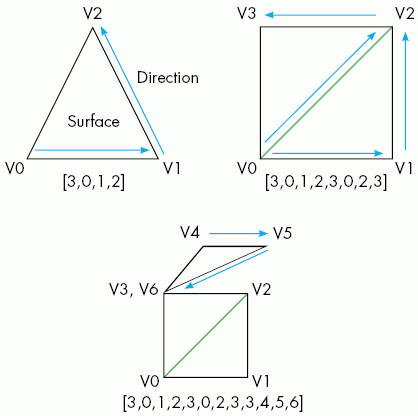

| PolygonTable | List of Integer | RW | Defines a polygon table in the form of an ordered list used for generating triangles of set.
In order to generate triangles, the vertex count of polygon is given first followed by the index for each vertex and so on for each subsequent polygon. For example, [3,0,1,2,3,0,2,3] would define two polygons with each having three vertices in which two are shared. Any polygon with four or more vertices will be tessellated. The actual positions of vertices are defined in PositionTable. See Example. Use polygon table to generate triangles for more information. |

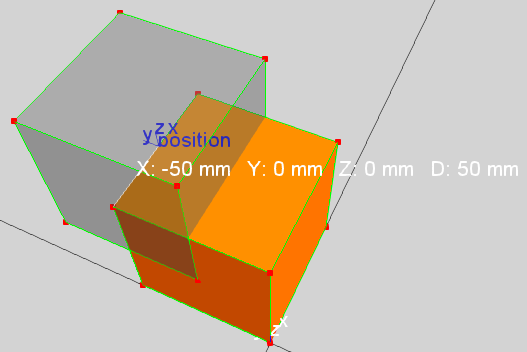

Example. Get position of points within an area filtered by direction
Clear cube and position frame are used to represent the area defined in getPointIndexesWithin() method with position and radius.
| from vcScript import * import vcVector #create block and collapse to quickly create triangle set comp = getComponent() gf = comp.findFeature('Geometry') if gf == None: gf = comp.RootFeature.createFeature(VC_BLOCK, 'Geometry') gf.collapse() #get triangle set gc = gf.Geometry tset = gc.GeometrySets[0] #use PositionTable to get position of every point in TriangleSet tset_points = tset.PositionTable #use position and radius to get position of points within area position = vcVector.new(50,100,100) point_index = tset.getPointIndexesWithin(position, 50.0) point_positions = tset.getPointPositions(point_index) print point_index #get point normals to filter point_normals = tset.getPointNormals(tset.TriangleTable) for i in range(len(point_normals)): for filter in point_normals: point_index = tset.getPointIndexesWithin(position, 50.0, filter) print point_index |

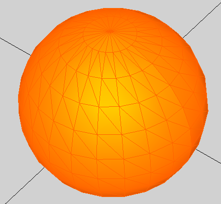

Example. Create sphere with triangle sets
| from vcScript import * import vcVector import vcMatrix r = vcVector.new(100.0,0.0,0.0) # Radius of the sphere is 100.0 m = vcMatrix.new() geofeat = getComponent().RootFeature.createFeature(VC_GEOMETRY,'MyGeometry') tset = geofeat.Geometry.createGeometrySet(VC_TRIANGLESET) for i in range(0,361,15): # Step every 15 degrees around Z (first and last coincident) for j in range(90,-91,-15): # Half circle in 12 sections around Y, # starting from south pole m.identity() # always reset the origin before rotate m.rotateRelZ(i) m.rotateRelY(j) p = m * r # transform the radius vector with reoriented origin tset.addPoint(p) for i in range(26): # i is the section around Z (12 in each) for j in range(12): # is around the rotating y axis tset.addTriangle(i*12+j,(i+1)*12+j,(i+1)*12+j+1) tset.addTriangle(i*12+j+1,i*12+j,(i+1)*12+j+1) geofeat.rebuild() getApplication().render() |
