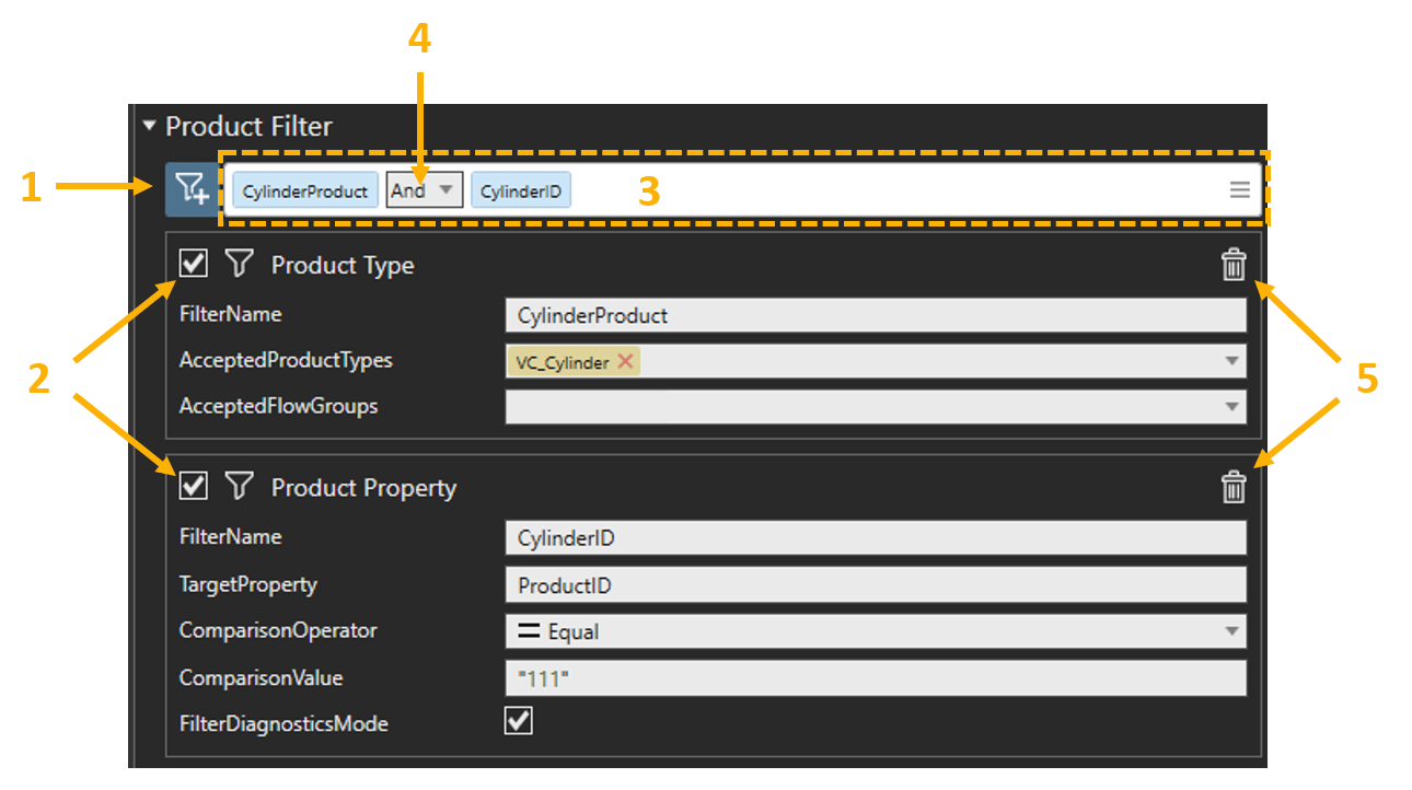

Product filters are used to filter the incoming products to the process. The filters are applied with TransportIn, TransportPatternIn, StartTransportIn statements and Assembly Editor.
The filter example below accepts only “VC_Cylinder” Product Types that also have a string type property named “ProductID” with a value of “111”.
| 1. | Create a new filter |
| 2. | Active filters |
| 3. | Shows all active filters |
| 4. | Operator to combine multiple filters |
| 5. | Delete filters |
