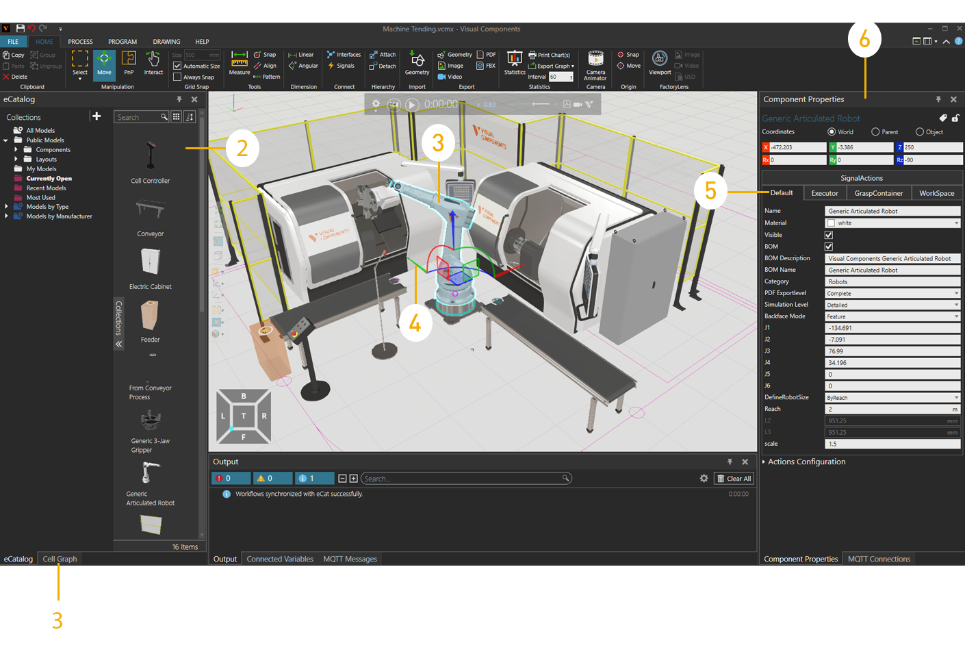

The Layout view allows you to build layouts in the 3D world using components.
1. Cell Graph Panel
2. eCatalog Panel
3. Selected Component
4. Manipulator
5. Property Tabs
6. Properties Panel

The Layout view shows, by default, the following panels:
  • eCatalog for browsing connected sources of files and adding them to a layout.
  • Cell Graph for listing, selecting and editing components in a layout.
  • Properties for reading and writing properties of selected components in a layout.
